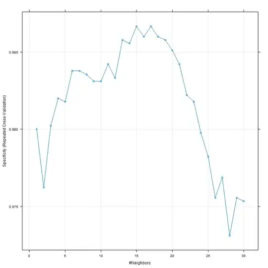

Both ROC and LogLoss seem to peak around 8: ROC logLoss
While sensitivity and specificity seem to peak around 15: Sens Spec

If you put a gun to my head, I'd probably say 8...

  • Thanks very much for that, I ran your code with 1,000 repetitions. The most interesting values seemed to be 14 and 17. – image_doctor Jul 03 '12 at 23:30

  • @image_doctor: You mention 14 and 17, but my feeling is that those two particular numbers wouldn't be superior if you actually went out and gathered some more iris data. My guess would be that the broad 5..20 peak is what it is, and the peaks and valleys in that range are artifacts of the Iris dataset, not of irises. – Wayne Jul 06 '12 at 14:52
