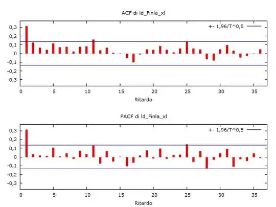

First question: Is it possible that the series before being differentiated had no outlier and after yes? I continued the analysis, linearizing the serie, obtaining enter image description here So I can begin to study the ACF and PACF enter image description here TRAMO suggested me to use ARIMA(1,0,0)(0,1,1), but I found that a simple AR(1) give the same result. These are the ACF-PACF of ARIMA(1,0,0)(0,1,1) residuals: enter image description here and these of AR(1) residuals enter image description here Comparing AIC and BIC, theory suggests to choose the AR(1). This is the output for the ARIMA

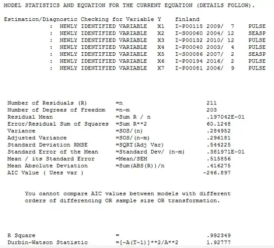

There are three kinds of additive outliers viz, Pulses, Level Shifts and Seasonal Pulses. Tramo Seats does not treat Seasonal Pulses correctly or perhaps not all due to ineffective implementation as it is non-trivial to implement. A Seasonal Pulse is an old-fashioned (but very useful) seasonal dummy which doesn't necessarily start at the beginning of the data. For example if we have 213 historical values but starting at 2004/12 (period 60) there is a consistently higher observation by .306 reflecting Christmas. This would lead to a dummy indicator of the form 59 0's followed by a 1 at the next period and each successive December. Additionally there is detected seasonal dummy required for February starting at period 86 reflecting a trading-day effect as February has fewer business days. The identified equation is hereenter image description here . IMO the fact that only two months have a hint of seasonality in no way suggests seasonal differencing.
The model statistics are here using AUTOBOX a piece of siftware that I have helped develop enter image description here and here enter image description here

1) Is it possible that the series before being differentiated had no outlier and after yes? Yes as the outlier may be hidden due to predictive structure that has yet to be identified much like being unable to "see" if your eyeglasses(filter/model) have a crack in them.
2) TRAMO suggests to use seasonale difference, but from the ACF/PACF it seems that it's not necessary. No there is no need for seasonal differencing just better analytics from Tramo-Seats identifying the need for Seasonal Pulses and their starting point. Unwarranted seasonal differencing INJECTS structure into the residuals (Slutsky effect ? e.g differencing a white noise series creates a new series with greater variance) rather than eliminating structure .

Finally the presence of a significant acf(11) might be suggestive that the current model is inadequate. There a few possible reasons for this 1) the need to add seasonal arima OR 2) the need to add seasonal dummies OR 3) an unwarranted differencing or power transformation.

  • Thanks for the answer IrishStat. I understood what you said, but I don't see the significant ACF(12). Maybe ACF(11)? – zick094 Nov 25 '17 at 13:36
  • I meant the acf(12) in your analysis. falsely suggesting the need for a seasonal arima structure to be added OR as TS falsely suggested the need for seasonal differencing. Modifications to models need to be as simple as necessary BUT not too simple. TS was just relying on the only remedy they have (perhaps killing the patient !). – IrishStat Nov 25 '17 at 13:53
  • I don't think to have understood.. In my analysis the ACF/PACF haven't significative lag 12, both differentiated series and resiual on AR(1) model. But you said " the presence of a significant acf(12) is suggestive that the current model is inadequate", what you meant? The residual of ARIMA one or of AR one? Thanks again. – zick094 Nov 25 '17 at 14:07
  • Perhaps your/TS (unwarranted) need to take logs caused the big difference in detecting the first major anomaly . Logs like any other forms of transformations (differencing,arima,detrending et al) can have negative consequences. See here for when and why to take power transforms https://stats.stackexchange.com/questions/18844/when-and-why-should-you-take-the-log-of-a-distribution-of-numbers. Notice that my plot of residuals in no way suggests a linkage between the expected value and the local variance. – IrishStat Nov 25 '17 at 14:08
  • when you observe a significant acf say at lag(11) or perhaps lag(12) or perhaps lag13 or mildly in your case (value .17 for lag 11 or so reading your graph) one might consider adding either a ma(12) or an ar(12) to the current model ... this is the iterative activity suggested by Box . Simply I was suggesting that TS was incorrectly responding to the (.17 for lag 11 from your graph) by suggesting ( as you wrote : TRAMO suggests to use seasonal difference) the incorrect need to consider adding seasonal differencing. – IrishStat Nov 25 '17 at 14:29
  • Ok, I understood. The problem is that without seasonal differencing every model I use (with seasonal part or not) cannot delete the significative correlation at lag(11). If I add seasonal differencing, I can find a model that delete that significative lag. What do you think about this? Is it possible that TRAMO suggests seasonal differencing just to make lag more significative and delete it using models with seasonal part? – zick094 Nov 26 '17 at 16:29
