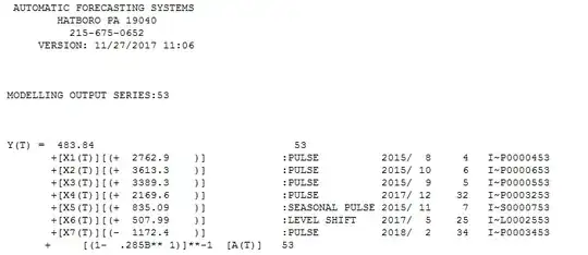

When you have data that has been effected by external factors creating model identification ambiguity a nuanced approach is important/critical to identify those effects and isolate them in order to form a more useful model. The eye (like statistical tools) works better when it is not occluded. With your data a few one time anomalies and a level shift one gets enter image description here a similar model form is the same as @STEPHAN and different forecasts coming off the recent level shift. enter image description here . The plot of the cleansed and actual is here enter image description here . The plot of the residuals enter image description hereand the acf of these residuals description here enter image description hereis a mandatory exercise to test the assumptions underlying the proposed model . The forecast plot is here enter image description herewith confidence limits reflecting possible future anomalies.
IrishStat
