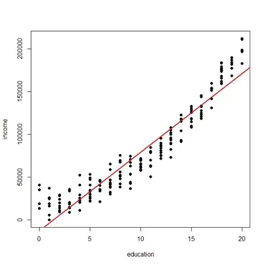

  2. This model may not make sense. For instance, you may have people in your sample with few years of education and low - but non-negative - starting income. For instance, your data and the regression line may look like this:
    set.seed(1)
    education <- sample(x=xx,size=200,replace=TRUE)
    income <- pmax(450*education^2+20000+rnorm(length(education),0,10000),0)
    (model.linear <- lm(income~education))
    plot(education,income,pch=19)
    abline(model.linear,col="red",lwd=2)
    linear regression
    Here, predicting for someone with 0 or 1 year of education is entirely warranted by your observation, but a negative prediction isn't. (Incidentally, linear predictions will not only underestimate income for low eduction, but also for high education.)
    The problem here is that your model is misspecified. The relationship between education and income is not linear.
