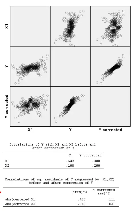

Example: Symmetric (X-like) heteroscedasticity
It is possible to correct specifically symmetric heteroscedasticities such as
where data cloud is either bow tie or rhombic about the mean of $X$ variable(s). In order to transform such shape to more homoscedastic, ellipsoidal one, re-define $W_j$ in the formula to be the centered $\text{abs(centered}X_j)$ variable. This is more radical training of $Y$ for homoscedasticity.
Example (the $X$ variables were used from the previous example, $Y$ was simulated different; notice the bow tie shape heteroscedasticity):
The heteroscedasticity decreased from $0.435$ to $0.111$. More than 20 iterations might be able to yield more success. The described iterative approach (starting from the one presented in the linked answer) are more successful if n is large and if there are many unique values in the data (i.e. input variables are continuous).
