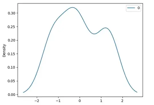

The reason why I think its not working is easy to show on an example:
data = [1.5]*7 + [2.5]*2 + [3.5]*8 + [4.5]*3 + [5.5]*1 + [6.5]*8
cdf = n.cdf(data, mean, std)
ppf = n.ppf(cdf)
df = pd.DataFrame(ppf)
df.plot(kind='density')
plt.show()
When I plot the ppf, the data looks exactly the same as the original data. But the original data is not normal distributed, so I expected it to look more like
enter link description here
In fact, the ppf function just makes the original data again. But I want to normalize the original data (which is not normal distributed) to a normal distributed one. (according to the picture). According to other post, if you do a cdf of a dataset and then use the normal invers of cdf, the values should be normal distributed, what is not the case
Maybe I explain myself wrong, if you have questions, feel free to ask....
The plot of my original Data:
Plot of my ppf Data... Same shape, but I want a normal distribution enter image description here
