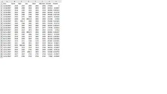

I am studying share price log returns and AR(1) model.
I downloaded data from FTSE100 and used the Adj.close column to find the Ln returns:
Now I am trying to understand how can I estimate an AR(1) model using this information. I understand the AR(1) model, I did a couple of example in excel, but I do not understand how the ln returns are related to that. AR(1) is given by:
$X_t=\phi+\alpha*X_{t-1}+\epsilon$
I assume that I need to find values for $\phi$ and $\alpha$ to try to fit the AR(1) model but I am confused. Can anyone help me on this? Thanks.

Since you are doing this in Excel, the simplest way would be to use linear regression (but not the best). Notice that if your model is
$$ Y_t = \phi + \alpha Y_{t-1} + \varepsilon_t $$
that it is basically the same as standard linear regression model
$$ Y_t = \beta_0 + \beta_1 X_t + \varepsilon_t $$
with $X_t = Y_{t-1}$.
Assuming that your $Y_t$ variable is stored in the A1:A100 cells, put lagged $Y_{t-1}$ in B2:B100 cells, by inserting there =A1:A99. Then you can extimate $\alpha$ =SLOPE(A2:A99, B2:B99) and $\phi$ =INTERCEPT(A2:A99, B2:B99).
