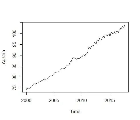

The time series is about the Harmonised Index of Consumer Prices in Austria from Janaury 2000 to September 2017, with base=100 2015 get it from Eurostat.

I follow the Box and Jenkins procedure. The first things I do is to visualize the time series. In this case, it's:
Firstly I wonder if there any kind of outliers (for example Addivite, Level shift, Innovation Outliers of Temporary change), that's not the case, I suppose. Obsviously it's not mean stationary and I have some doubts on the variance of the series. So I'm gonna consider a log-transformation and a difference of order 1.

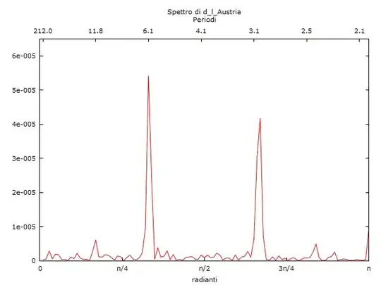

At this point I remember that if the case that seasonality is evolutive, we prefer to consider a multiplicative model for time series. Anyway I'm gonna check now the periodgram of this series and that's what I get:enter image description here
This should show me (if I'm not wrong) that we have a seasonaly every 6 months and 3 months.

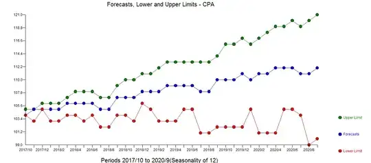

i took your 213 monthly values into AUTOBOX , a piece of software that I have helped to develop. It suggested that there was a significant change in parameters at or around period 126. The final model is here enter image description here containing both memory and dummy indicators. A level shift is in general an intercept change. The stats are here enter image description here and here enter image description here . The Actual/cleansed graph is informativeenter image description here while the ACTUAL/Fit/Forecast is a nice summary enter image description here with a plot of the model enter image description hereresiduals here supporting sufficiency. The plot of the forecasts is here suggesting increasing uncertainty going forward enter image description here .

If you look closely at the plot of the original series you can visually detect what AUTOBOX discovered is that there appears to be either a structural change in parameters or a structural change in error variance (more visual variability a t a higher level. This linkage between the variance anD the level of the series CAN often be mis-interpreted as justification for a Box-Cox log transformation
