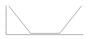

If I recall correctly SVM-regression has a loss function like this:
plot of epsilon-insensitive loss
That corresponds to a density that is uniform in the middle with exponential tails (as we see by exponentiating its negative, or some multiple of its negative).

There's a 3 parameter family of these: corner-location (relative insensitivity threshold) plus location and scale.
It's an interesting density; if I recall rightly from looking at that particular distribution a few decades ago, a good estimator for location for it is the average of two symmetrically-placed quantiles corresponding to where the corners are (e.g. midhinge would give a good approximation to MLE for one particular choice of the constant in the SVM loss); a similar estimator for the scale parameter would be based on their difference, while the third parameter corresponds basically to working out which percentile the corners are at (this might be chosen rather than estimated as it often is for SVM).
So at least for SVM regression it seems pretty straightforward, at least if we're choosing to get our estimators by maximum likelihood.
