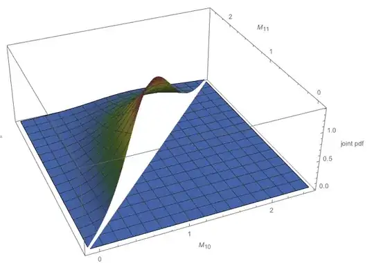

  • In $\frac{1}{11}$ cases, the $11^\text{th}$ term will be LARGER than $M_{10}$, in which case $M_{11} > M_{10}$.
The following diagram plots the exact theoretical solution $g(x_{(10)}, x_{(11)})$ derived above:

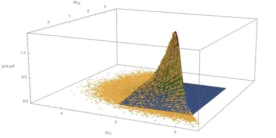

Finally, the next diagram compares the empirical joint pdf of $(M_{10}, M_{11})$ to the theoretical solution $g(x_{(10)}, x_{(11)})$ derived above:
