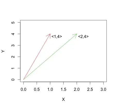

The graph below shows an example of the formula for linear dependence. You can see that the vectors are linearly dependent because one is simply a multiple of the other. enter image description here
This is in contrast to linear independence, which in $\mathbf{R}^2$ is described by: $$ \textbf{v}_{1}\neq a\textbf{v}_2 $$ for vectors $\textbf{v}_1, \textbf{v}_2 \neq \textbf{0}.$ An example of linear independence can be seen in the graphic below. enter image description here
