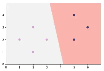

I have trained a model of Ridge classifier on the following dataset:
X = [[2,1], [2,3], [1,2], [3,2], [5,2], [5,4], [6,3]]
y = [1, 1, 1, 1, 0, 0, 0]

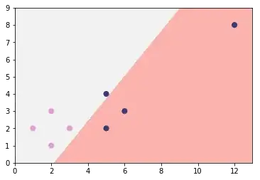

In the second example i add a new example [12,8] to X and train. Why does regression behave in such way that it readjusts the boundary, kicking the example (5,4) on the other side ?
linear_regression_1 linera_regression_2

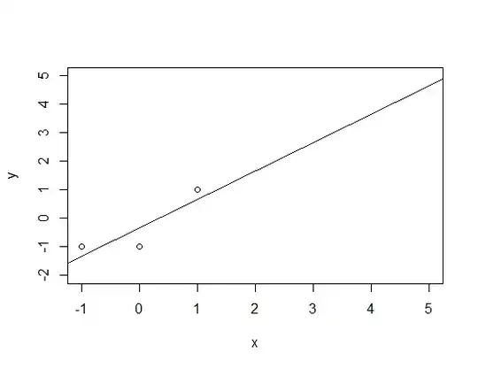

New, corrected answer: (just putting bibliolytic's answer into pictures)
Let us take a one dimensional situation. We have one input feature $x$ from which we want to predict some boolean valued $z$. The first thing we do is cast $z$ to a real value like so: false becomes $-1$ and true becomes $1$. Then we compute a usual regression model $L$ and make the prediction as follows: $x$ gets predicted as true iff. $L(x) > 0$. Let us assume that we have the following data set:
 x |  y
-1 | -1
 0 | -1
+1 | +1
we learn the model $L(x) = x - 1/3$: enter image description here
Now let us see what happens when we insert a new point far away (say a positive sample for $x=5$) into the image: enter image description here The old regression line (black line) does not fit the data anymore but the interesting thing is why it does so: By doing a linear regression and ignoring the fact that $y$ is actually $-1, +1$--valued one punishes 'the red line'! Although we have a predictor that says 'if $L$ is big then I predict true' and the value of $L$ is very big at $x=5$ one still punishes the model. One should not do that because the old black line would suit the situation just fine!
The new regression line must adapt to this large red gap: As it is the line that produces the least error (and it has the highest possibility of making an error at $x=5$) it will fit $x=5$ particularly well but then it has to 'bow down' around the origin causing the line to predict $L(0) \approx -0.08$, i.e. our prediction at $x=1$ would become false; the model 'kicks' out this positive sample from the positive region!
