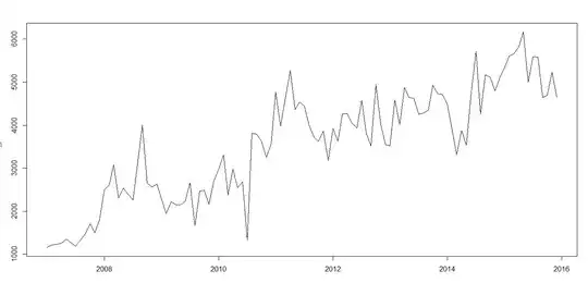

If there is any method/test to check whether the seasonal component is significant in R.
Ferdi
  • 5,179
  • How to do anything in R is off-topic here without a statistical core, but it would be easy to generalise your question. However, the seasonality tag shows many questions on the topic, so what is new and different here? One short answer is by drawing a plot that is different, as plots of time series extending over several years are poor for identifying seasonality; naturally, more can be said. A minute but not trivial detail with your plot is that although years are intervals your labelled axis ticks are at points and remain ambiguous unless the graph convention is spelled out. – Nick Cox Oct 27 '17 at 11:59
  • Plot data versus time of year is a recipe surprisingly often omitted. – Nick Cox Oct 27 '17 at 12:05
