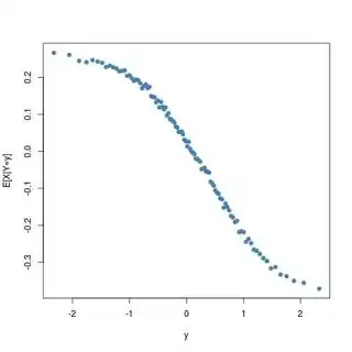

Here is an example using the Ali-Mikhail-Haq copula: with cdf $$F_\theta(x,y)=\dfrac{xy}{1-\theta(1-x)(1-y)}\qquad\theta\in(-1,1)$$ and associated joint density $$f_\theta(x,y)=\dfrac{1+\theta[(1+x)(1+y)-3]+\theta^2(1-x)(1-y)) }{[1-\theta(1-x)(1-y)]^3}$$ Simulating a sample from the conditional distribution associated with this joint distribution (by Metropolis-Hastings) and applying the Normal quantile function transform to the sample returns the following graph of $\mathbb{E}[X|Y]$ for $\theta=0.5, -0.9$, clearly not a linear regression: enter image description here enter image description here
