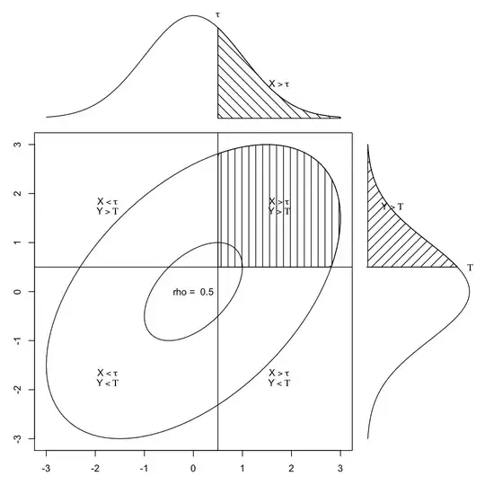

My best bet is that you are facing large imbalance between your response categories, for some of your items.
If you assume that your binary responses reflect individual locations on an underlying latent (i.e., continuous) trait, then correlating the two variables is ok, provided the cutoff is close to the mean of the bivariate density, as shown below (here cutoffs were set symmetrically at $(.5,.5)$, for a correlation of 0.5):
alt text
In this case, Pearson correlation will underestimate the true linear relationship between the two latent traits, especially in the mid-range of the correlation metric. On the other hand, when the cutoffs are clearly asymmetrical on both continuous variables, the tetrachoric correlation will generally overestimate the true relationship. The following picture illustrates the ideal case.

Now, you can play with the value of the cutoff, $\tau$, and see what happens when it is asymmetric and largely departs from the mean of the joint density of $x$ and $y$.
