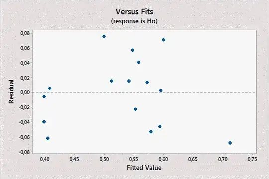

I performed a multiple linear regression and after checking my results everything seems to be great, but when I checked the residuals I noticed this patterns in the attached figure and I am not sure if it's right or not. I think there are two (or maybe three) groups. Am I right? Or this is a a random distribution? If there are two or more groups, what should I do next?

  • well, If I were you I would check distribution of residuals since in MLR the residuals are supposed to be normally distributed. It should be available in Minitab as far as I remember. – gunakkoc Oct 13 '17 at 00:12
  • The residuals are normally distributed (without outlier) – Billo Oct 13 '17 at 00:45
You seem to have 3 groups of predicted values. This looks like you have one categorical predictor that takes 3 levels and one or more continuous predictor, but that the categorical predictor has a stronger relationship. That is not, in itself, a problem. But if the residuals are related to the fitted values, that is a problem. However, you have so little data that it is hard to tell.
The fact that you have so little data makes me worry about overfitting.
