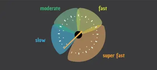

This much be a popular topic in the thralls lately, as the Visual.ly blog just came out with a post on the topic as well, Speedometer Design: Why It Works. In there they give credence to some of the things gung mentions in his post that I am somewhat critical about in the comments, in particular how we develop a gestalt for identifying locations around the circular display.
visually relative areas of speed circular display
I think I'm partially coming around to this notion. A circular display provides more visual distinction between general areas than does a linear one. For a general example, it is easier to quickly tell the difference between a needle pointing to 3 o'clock and a needle pointing to 12 o'oclock than it is to tell the difference between 15 and 12 on a linear scale.
I'm still not totally convinced though, and I say rubbish to the notion that acceleration is easier to distinguish on a circular scale (or even if it is information we need the dashboard to inform us about anyway) that the visual.ly blog post mentions. Just my opinion though, I'm not sure any of us have been citing directly pertinent experimental results on human perception. Cleveland's is a start, but not likely to give an entirely satisfactory answer to these particular circumstances.
That being said the multiple data values are still the main crux of the argument, circular displays aren't good for multiple data values.
