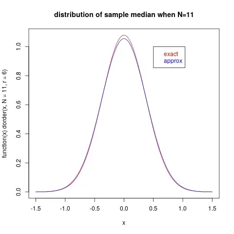

I will make some illustrations with R. First, using results discussed at Central limit theorem for sample medians the asymptotic distribution of sample median of $N$ iid observations from a normal distribution is itself a normal distribution centered at the theoretical median $\mu$ and with variance $\frac{2\pi \sigma^2}{4 N}$ where $\sigma^2$ is the variance of the parent distribution. The sample median is the central order statistic, and in the case $N=2s+1$ is odd, it is the order statistic of order $s+1$, which have a distribution we can calculate exactly rather easily (theory given in the cited post and elsewhere at this site). I will use some R function I detail at the end of this post to compare the exact and approximate distributions of the sample median. We use the standard normal for parent distribution.
First with sample size $N=11$:
The approximation is already quite good! Let us look at the case $N=101$:
