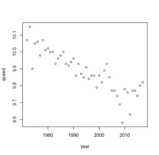

Contrary to other answers, I'd argue that you can say something about Bolts abilities given the available data. First of all, let's narrow your question. You are asking about fastest human, but since there is a difference in the distributions of running speeds for men and woman, where the best woman runners woman seem to be slightly slower then the best man runners, we should focus on men runners. To get some data, we can look at the best year performances on 100 run from the last 45 years. There are several things to notice about this data:
  • Those are the best running times, so they do not tell us about abilities of all humans, but about the minimal achieved speeds.
  • We assume that this data reflects sample of the best runners in the world. While it might have happened that there were even better runners that did not participate in the championships, this assumption seems to be fairly reasonable.
First, let's discuss how not to analyze this data. You could notice that if we plot the running times against time, we would observe a strong linear relationship.
Best running times vs time
This could lead you to using linear regression to forecast how much better runners we could observe in the next years. This however would be a very bad idea, that would inevitable lead you to conclusion that in approximately two thousand years humans would be able to run 100 meters in zero seconds, and after that they would start achieving the negative running times! This is obviously absurd, as we can imagine that there is some kind of biological and physical limit of our capacities, that is unknown to us.
