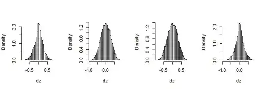

Histograms of increments of z
These are histograms of the increments of the individual coordinates. Note how the middle histograms differ from the outer ones.
