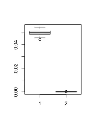

The results follow: enter image description here
On the left, we see (i) the FDR for 100 replicates where we control FDR on each hypothesis separately; on the right we see (ii) the group control for 100 replicates.
So method (i) closely matches the control rate, while method (ii) (Benjamini-Hochberg) is extremely conservative in this sense.

I would like to know where you got the notion that FDR is overly cautious; that is very much not the impression that I have. Indeed many people have found that the empirical FDR closely matches the control rate except in circumstances of special kinds of dependencies (see a discussion of that here). What you found in your simulation was not FDR but the false positive rate. You had no true positive associations so your FDR was always 1 by definition, as FDR is the expected value of false positives over all positives. You created a set up where data were randomly generated and you found 1) the P value and 2) the BH corrected P value (the $q$-value is actually a different concept and unique to John Storey's implementation $^2$). You found that 5% of uncorrected P values rejected the null when all were false, which is the meaning of setting $\alpha$ to 0.05 which you did. You also found that 0% of FDR corrected P values rejected the null, which is entirely to be expected as you had no true positives to identify and your results were all within the realm of chance. So really, you found that FDR was doing exactly what it was supposed to do!
