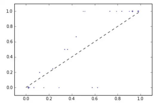

I have about 1000 samples with 20 features and I'm using Random Forest to predict a binary class.
I'm trying to apply the probability calibration process as described on scikit using CalibratedClassifierCV.
I've noticed that even though the log-loss improves after the process, the reliability graph looks much worse after calibration. I've used make_classification to create samples for this post, and this is the reliability graph I'm getting prior to calibration: Reliability graph before calibration
After using CalibratedClassifierCV, the log loss indeed improves, but here is how the reliability graph looks like: Reliability graph after calibration
Need to say that when I'm using my own real data, the calibrated graph looks even worse (all of the probabilities are in the range of 0.45 to 0.55).

I hoped you could help me understand why the calibration process doesn't seem to work so well.
The short answer is that your reliability graph is not actually worse. It just looks worse because the bins in the center of distribution have very few points, so the (empirical) probability jumps around.
I suggest using the ml_insights package for calibration. (Disclaimer: I am a primary author of the package). It has a function plot_reliability_diagram which lets you easily control the bins used, as well as a (default) option displaying the points sized by the number of points in the bin.
So, in your terminal, run pip install ml_insights
Then try the following code at the end of the code you posted above.
mli.plot_reliability_diagram(y_test,probs_sigmoid[:,1], c='blue') enter image description here
But if we use fewer bins, we see a clearer picture:
mli.plot_reliability_diagram(y_test,sigmoid[:,1], bins=[0,.1,.2,.4,.6,.8,.9,1], c='blue')
