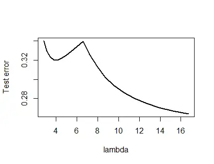

Edit (to respond to the changed question)
I was so confident in the analysis presented below and the intuition behind it that I set about finding an example in the crudest possible way: I generated small random datasets, ran a Lasso on them, computed the total squared error for a small training set, and plotted its error curve. A few attempts produced one with two minima, which I will describe. The vectors are in the form $(x_1,x_2,y)$ for features $x_1$ and $x_2$ and response $y$.
Training data
$$(1,1,-0.1),\ (2,1,0.8),\ (1,2,1.2),\ (2,2,0.9)$$
Test data
$$(1,1,0.2),\ (1,2,0.4)$$
The Lasso was run using glmnet::glmmet in R, with all arguments left at their defaults. The values of $\lambda$ on the x axis are the reciprocals of the values reported by that software (because it parameterizes its penalty with $1/\lambda$).
An error curve with multiple local minima
Figure
Analysis

Figure showing apossible graph of e.
Qualitatively, there are three possibilities:
  • The prediction for the training set never changes. This is unlikely--just about any example you choose will not have this property.
  • Some intermediate predictions for $0\lt \lambda \lt \infty$ are worse than at the start $\lambda=0$ or in the limit $\lambda\to\infty$. This function cannot be convex.
  • All intermediate predictions lie between $0$ and $2y_0$. The continuity implies there will be at least one minimum of $e$, near which $e$ must be convex. But since $e(\lambda)$ approaches a finite constant asymptotically, it cannot be convex for large enough $\lambda$.
The vertical dashed line in the figure shows where the plot changes from convex (at its left) to non-convex (to the right). (There is also a region of non-convexity near $\lambda\approx 0$ in this figure, but this won't necessarily be the case in general.)
