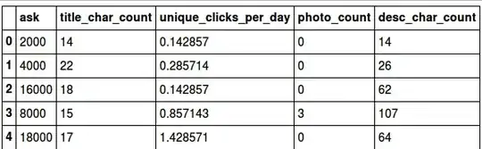

This is the head of the data (summarized; the actual data has more features). unique_clicks_per_day is actually unique_bids_per_day.

  • What are the possible values that unique_bids_per_day can take on? If it is not 0 and 1 then without recoding, you cannot use this variable in a logistic regression. If you could provide a snapshot of the first few lines of your data it would help folks at the site better address your modeling questions. – Matt Barstead Aug 08 '17 at 16:50
  • @MattBarstead: Added the head at the end of the question. One way to recode unique_bids_per_day could be to calculate median_bids_per_day, and then classify all values above median as 1, and 0 otherwise. However, this way, I'd lose some information. Could there be a better way to accomplish the inference I want? Responders to the question I've linked to seemed to imply Binomial regression is the way to go (which I assume is the same as logistic in this case). – Hassan Baig Aug 08 '17 at 17:24
  • I guess a fundamental question is what does the value .142857 represent in the first row of unique_clicks_per_day? It can't be number of clicks because it is not an integer and it doesn't seem like it is a proportion as there is a value in the same vector that exceeds 1. (it is also repeated in the third row of data though that could be a coincidence). – Matt Barstead Aug 08 '17 at 18:49
  • @MattBarstead: it's basically total unique clicks garnered in 7 days, divided by 7. 7 days is the life of a single auction. – Hassan Baig Aug 08 '17 at 19:04
  • Okay understood. So my thought is that one option is to not perform the linear transformation and keep your measure as total unique clicks. Each auction sounds like it last for the same length of time so there is nothing to be gained by standardizing to a daily click rate from an analytical standpoint (it only alters the interpretation). The untransformed variable is now a count variable (has to be an integer between 0 and infinity), and you can now use a generalized linear model (specifically using the Poisson link function). – Matt Barstead Aug 09 '17 at 01:43
