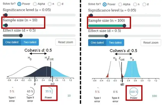

I would like to list another intuitive example.
Suppose I tell you I can predict the outcome of any coin flip. You do not believe and want to test my ability.
You tested 5 times, and I got all of them right. Do you believe I have the special ability? Maybe not. Because I can get all of them right by chance. (Specifically, suppose the coin is a fair coin, and each experiment is independent, then I can get all rights with $0.5^5\approx0.03$ with no super power. See Shufflepants's link for a joke about it).
On the other hand, if you tested me large number of times, then it is very unlikely that I can get it by chance. For example, if you tested $100$ times, the probability of me getting all of them right is $0.5^{100}\approx 0$.
The statistical concept is called statistical power, from Wikipeida
The power of a binary hypothesis test is the probability that the test correctly rejects the null hypothesis (H0) when the alternative hypothesis (H1) is true.
Back to the super power on coin flip example, essentially you want to run a hypothesis testing.
  • Null hypothesis (H0): I do not have the super power
  • Alternative hypothesis (H1): I have the super power
Now as you can see in the numerical example (test me 5 times vs test me 100 times), The statistical power has been affected by the sample size.
More to to read here. (more technical and based on t-test).
An interactive tool to understand statistical power can be found here. Note, the statistical power changes with the sample size !

    This does not actually answer the question. The question has two parts: "Why is [it] more convincing…" and "What is this characteristic called in statistics?" You provided an example that asks the reader if they are more convinced by the example, but you have not explained the phenomenon, nor attempted to address why it's more convincing (just relying on the reader's intuitive reasoning on a single example). In addition, you haven't touched on the second question: If you believe this phenomenon doesn't have a name, then explicitly state that. – Makyen Jul 29 '17 at 17:48
    @Mayken That is plainly an attempted answer. It's not the greatest answer and it's not a complete answer but partial or socratic answers are not grounds for claiming it's not an answer at all. Questions should ask one question and if they ask a series of questions I think it's perfectly reasonable (if less than ideal) to only address some of them. If you feel it's a poor answer, you're certainly free to address the issues you see as problems. [For that matter I don't think I answered the second question either; I only discussed the effect; not every phenomenon will have an explicit name] – Glen_b Jul 30 '17 at 07:01
  • @hxd if you feel your link has important information, would you mind summarizing it in your answer? – Glen_b Jul 30 '17 at 07:02
    I can't help but feel like 100% is a special case and this answer doesn't really support my intuition that 600/1000 is more convincing than 6/10. Even if we take it to not be a special case, this is essentially just restating the problem with a different percentage. – NotThatGuy Jul 30 '17 at 23:14
    @Makyen I agree this is not a good answer and do not know why getting many votes.. I wrote this in Friday with 5 min. Thanks for your feed back and I will try to revise it today. – Haitao Du Jul 31 '17 at 13:44
  • @Glen_b CV is strange, I have no idea why getting vote for this types of answer... I spent more time on other ones but get little votes. Thanks for feedback and I will spend time to revise the answer from he link I provided. – Haitao Du Jul 31 '17 at 13:45
    @hxd Sometimes it's hard to understand why some of our answers do so much better than other answers we have that are better. Sometimes it's that the answer hits the hot network questions list which can get a lot of attention from a very different audience than the usual one. I think the best strategy when that happens is to do what you can to improve the answer. . – Glen_b Jul 31 '17 at 14:05
  • @Glen_b, Sorry I didn't respond. I was not notified of your comment in my inbox. I agree with all your points. I did not intend to claim it was "not an Answer" (by SE definitions), nor did I flag it as such. It's clearly an Answer, because it does attempt to answer the question. My comment was intended to convey I felt it was an Answer which was deficient, not that it was "not an Answer". I agree that I could/should have worded my comment better such that it conveyed that distinction more clearly, without unintentionally using phrasing similar to what is seen in the review queues. – Makyen Jul 31 '17 at 15:00
  • I thank you. May I know using what software you have produced the nice informative pictures? – Juya Aug 08 '17 at 15:51
    @Juya it is a web based tool built by someone. You can try it here – Haitao Du Aug 08 '17 at 15:59
