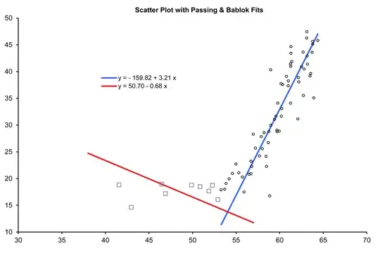

  • From the simulation above, Theil regression would probably offer a better fit. – Carl Jul 17 '17 at 23:38
    @Carl Definitely not, because the simulation is constructed according to the model I have posited. What might be true is that a robust regression method would continue to provide reasonable fits for other forms of simulation in which the conditional error distributions are non-normal--but that is not the question we are concerned with here. – whuber Jul 18 '17 at 12:12
  • The slopes from the model posited do not reflect the generating slopes in gray. Theil regression would not be so much in error. Please post the simulation data. – Carl Jul 18 '17 at 16:42
  • @Carl The $x$ values are $1,2,\ldots,40$. Here are corresponding $y$ values, rounded for brevity. $$(-0.045,0.761,-1.699,-5.452,-2.684,-7.497,-6.081,-5.85,-12.234,-13.9,-13.458,-17.07,-17.114,-22.436,-20.226,-22.828, -6.423,-13.609,-3.611,-0.496,3.215,-14.231,-11.849,27.103,-3.936,25.398, 12.761,17.888,22.735,9.328,5.336,11.598,15.816,-21.342,13.749,31.268,29.36,31.523,47.777,40.752)$$ I will also post the simulation code in this answer because fitting one particular data set is not the concern: what matters is how well a procedure works when applied to comparable datasets generally. – whuber Jul 18 '17 at 16:52
  • @whuber Any suggestions for where to learn more about the MLE approach you use? I don't understand you're doing there. – Ceph Jul 18 '17 at 18:18
  • @Ceph You can find many worked examples, illustrations, and code on our site. Search https://stats.stackexchange.com/search?q=%5Bmaximum-likelihood%5D+regression. – whuber Jul 18 '17 at 18:33
  • @whuber The points you list are correct for regression by ordinary least squares because the $x$-values are equidistant and sequential integer values. That does not represent a reasonable model for the distributed $x$-values in the OP question. – Carl Jul 26 '17 at 02:15
  • @Carl, I think I will stop responding, because you are repeating your incorrect claim that OLS requires such x-values. I would like to suggest that you consider experimenting with other choices of x-values (the code readily accepts such a change--simply modify the second line). You will discover that every part of this answer works as advertised. Please consult a regression textbook if you have further objections. – whuber Jul 26 '17 at 13:27
  • @whuber I have modeled this many times. For example, see https://stats.stackexchange.com/questions/251700/when-are-ols-linear-regression-parameters-inaccurate. I await your counter example. – Carl Jul 26 '17 at 21:21
    @Carl I find that question incomprehensible and the simulation irreproducible: the vague description ("let us vary both Xi and Yi ({X2,Y2} in code), reduce the standard deviations..."), incomplete screenshot of a spreadsheet, and nonsensical analysis of residuals simply don't indicate what you have done with enough clarity to formulate a response. – whuber Jul 26 '17 at 21:30
  • @whuber You are smart enough to make sense of it. A conventional enough answer, if also somewhat deprecating, is included as https://stats.stackexchange.com/a/251714/99274. Stats is not immune to espousing dogma that is nonsense, for example, as frequently occurs with regards to unbalanced physical units, and not all outsiders are idiots. – Carl Jul 26 '17 at 22:24

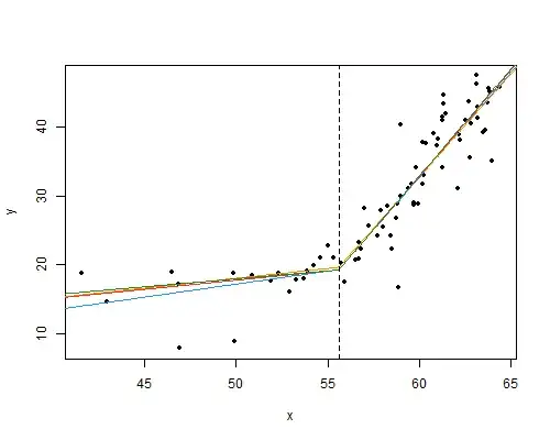

I thought it might be useful to illustrate the application of @whuber's linear-spline model to the data presented as an example in the question. The main thing is that for a known location, $x_0$, of the corner—@Sal Mangiafico's answer deals with joint estimation of that & the other parameters— it's linear in the parameters. Ordinary least-squares estimation is far from being the only game in town for fitting linear models, but it's well-known what properties it has under what conditions, & often constitutes at least a useful exploratory analysis in which it can be examined which of those conditions obtain & which not, suggesting other methods to apply.
A least-squares fit of the linear-spline model to the data (taken from the graph) gives
Call:
lm(formula = y ~ x + x.plus, data = dd)
Residuals:
     Min       1Q   Median       3Q      Max
-12.5041  -1.6519   0.2423   1.9444  10.7108
Coefficients:
            Estimate Std. Error t value Pr(>|t|)
(Intercept)  -1.6770     9.8149  -0.171   0.8648
x             0.3780     0.1862   2.030   0.0461 *
x.plus        2.6665     0.3233   8.247 5.82e-12 ***
Signif. codes:  0 ‘***’ 0.001 ‘**’ 0.01 ‘*’ 0.05 ‘.’ 0.1 ‘ ’ 1
Residual standard error: 3.984 on 71 degrees of freedom
Multiple R-squared:  0.8548,    Adjusted R-squared:  0.8507
F-statistic:   209 on 2 and 71 DF,  p-value: < 2.2e-16
& it might be interesting to compare it to a model allowing a jump at $x_0$ rather than a corner:
$$Y_i = \beta_0 + \beta_1 x_i + \beta_2(x_i-x_0)^{+} + \beta_3\mathbf{1}(x_i>x_0) + \epsilon_i$$
Call:
lm(formula = y ~ x + x.plus + x.RH, data = dd)
Residuals:
-12.4672  -1.6247   0.2558   1.8407  10.7461
Coefficients:
(Intercept)  -2.3868    11.9154  -0.200    0.842
x             0.3930     0.2343   1.677    0.098 .
x.plus        2.6652     0.3258   8.180 8.53e-12 ***
x.RH         -0.2047     1.9187  -0.107    0.915
Residual standard error: 4.012 on 70 degrees of freedom
Multiple R-squared:  0.8549,    Adjusted R-squared:  0.8486
F-statistic: 137.4 on 3 and 70 DF,  p-value: < 2.2e-16
The regression lines on each side are very close to meeting where they're supposed to on the corner theory; &, from the standard error estimates above a 95% confidence interval for $\beta_3=0$ is $(-4.0,3.6)$:
Diagnostic plots of the residuals suggest, rather than heteroskedasticity, outliers or a fat-tailed error distribution, with especially influential points to the far left:
QQplot of residuals residuals vs fits influence plot
A smattering of robust regression methods—median regression (orange line), & M-estimation with Huber (red) & Tukey's biweight (green) objective functions—give rather similar fits to each other while reducing the slope on the left-hand side relative to the least-squares solution :

rlm(y ~ x + x.plus, data=dd, method="M", psi=psi.bisquare,  scale.est="MAD") -> mod.TukeyBW
png("plot3.png", width=500, height=400)
with(dd,plot(x, y, pch=20))
lines(dfp$x, predict(mod.ls, newdata=dfp), col="dodgerblue")
lines(dfp$x, predict(mod.medreg, newdata=dfp), col="darkorange")
lines(dfp$x, predict(mod.Huber, newdata=dfp), col="firebrick1")
lines(dfp$x, predict(mod.TukeyBW, newdata=dfp), col="forestgreen")
abline(v=x.c, lty=2)
dev.off()

Compare this illustration with the OP's and see if you can see what I see. I have two sizable problems with the original regressions shown. The first is that both regression lines have visually obviously flattened slopes. The second is that the left line does not have homoscedastic residuals. Now, to proceed with calculation of slope confidence intervals, where I, admittedly personally, have no confidence in the aptness of the regression lines shown is derivative enough to give me pause for thought. In particular, there is so-called omitted variable bias, and this is more pronounced at the end points of the regressions. I would suggest using Theil regression to reduce this bias. However, as stated the problem has no exact solution, and all that can be done is to do a median (approximate) regression for this bivariate problem. Supply the actual data, and I will show this.
The results are very dependent on what the cut point is, and the regression method used. For example, if I use @Scortchi 's data and a slightly lesser x-value cut point and Passing-Bablok conversion regression (type III) for the left hand points and Passing-Bablok regression type I for the right hand points I get significant slopes and intercepts as below:
Now, the left hand points would not have either significant slope nor intercept using ordinary least squares regression, but do using Passing-Bablok regression. If I move the cut point to the right, as for Scortchi this significance for the left hand regression disappears.
Next thought, I think the data is inadequate to prefer two lines over a single function with local terms; let us say a mixture of two exponential functions, e.g.,
