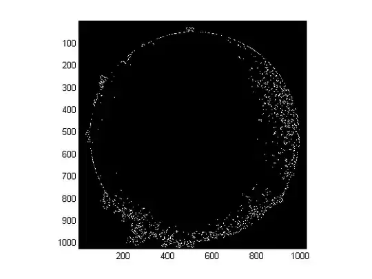

In dimensionality reduction technique such as Principal Component Analysis, LDA etc often the term manifold is used. What is a manifold in non-technical term? If a point $x$ belongs to a sphere whose dimension I want to reduce, and if there is a noise $y$ and $x$ and $y$ are uncorrelated, then the actual points $x$ would be far separated from each other due to the noise. Therefore, noise filtering would be required. So, dimension reduction would be performed on $z = x+y$. Therefore, over here does $x$ and $y$ belong to different manifolds?
I am working on point cloud data that is often used in robot vision; the point clouds are noisy due to noise in acquisition and I need to reduce the noise before dimension reduction. Otherwise, I will get incorrect dimension reduction. So, what is the manifold here and is noise a part of the same manifold to which $x$ belongs?

  • Thank you for your answer supported with a simple example and the picture. Can you please explain what a topology is in non-technical term as well? Is the term topology and manifold used interchangeably? Does the dimension has to be an integer number? What is it is a real number, then I think the structure is known as fractals if the entire structure is composed of each subpart is self-repeating. Lastly, in the picture there are three empty parts, hollow without the green material still why it is a continuous geometric structure? – Ria George Jul 08 '17 at 18:30
  • Then, can you please include the case of noise that I asked in my question? In a point cloud data, say there are outliers (noise). Would the noise be considered part of the same manifold as the non-noise data? – Ria George Jul 08 '17 at 18:38
    @RiaGeorge In the picture it is the surface that is a manifold. It's continuous because you can move around it freely without interruption and never have to jump off the surface to get between any two places. The holes you allude to are important in describing how you can get around on the surface between any two points in the simplest way, and counting them is an important technique in studying manifolds. – Matthew Drury Jul 08 '17 at 18:58
