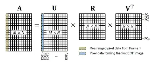

I am trying to enhance the contrast in the images I get after scanning a surface using Thermography (Principal Component Thermography ~Rajic, which is basically an application of Principal Component Analysis) to see the defects clearly.
But my question here is to understand the difference between empirical orthogonal functions and Principal Components as shown below: figure SVD is used to decompose matrix A into U, R, and V.
In my case, I have 20 images. And after doing a raster like operation to unroll an image in a column, I get my matrix A which has 20 columns and each of them represents one image.
Any intuitive explanation will be really appreciated.

  • Each image is 180180. I put each image in column, so my matrix A comes out to be 3240020 and then I center rows before doing SVD. Am I right? – Rumi-Thermo Jul 06 '17 at 04:40
  • Yes. So "EOFs" are of length 32400, meaning these are PCA eigenvectors aka "principal directions" aka "principal axes" aka (in image processing) "eigenfaces". What is called "PCs" on this figure are PC scores (normalized to unit length). See the thread linked above. Does it make it clear? – amoeba Jul 06 '17 at 07:19

  • See point #6 in the linked answer... Re covariance matrix, it's the same issue: whether samples are in rows or in columns of the data matrix. It's standard in statistics to have samples in rows, but on your figure in this Q you have them (images = samples) in columns. – amoeba Jul 06 '17 at 08:23
  • @amoeba I think now I got it, so if I put my images in rows instead of columns then "V" will be my principal direction/axes and "U" will be principal component as explained in the linked answer – Rumi-Thermo Jul 06 '17 at 08:28

  • @amoeba Sorry, I was checking my code and found a mistake in it. You are right irrespective of the contents of matrix X both equations hold. But the only confusion left with me now is that when is U a principal component and when is V a principal component, and does it has to do with size of matrix e.g. if I have size (n*m) matrix, then we have nm? something similar is explained on this link link but I think the author has done some mistakes in equations, it's hard to follow him. – Rumi-Thermo Jul 07 '17 at 11:33
  • The size of X does not matter, what matters is only the orientation: whether samples are in rows or in columns (as explained here https://stats.stackexchange.com/a/134283, in particular #6 as referenced earlier). – amoeba Jul 07 '17 at 11:34
