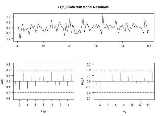

The residual plots (below) for (1,1,0) with drift shows independent random residuals with equal variance enter image description here

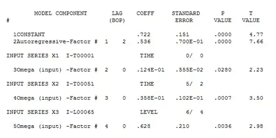

enter image description here detailing both a trend change (51) and an intercept change (65). Model diagnostic checking (always a good idea in iterative approaches to model form) yielded the following acf enter image description here suggesting that improvement was necessary to render a set of residuals free of structure. An augmented model was then suggested of the form enter image description here with an insignificant AR(1) coefficient.
The final model is here enter image description here with model statistics enter image description here and here enter image description here
The residuals from this model are presented here enter image description here with an acf of enter image description here

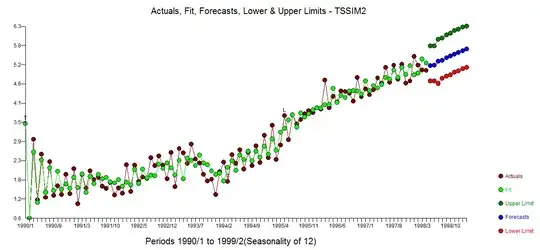

The Actual/Fit and Forecast graph is here enter image description here . The cleansed vs the actual is revealing as it details the level shift effect enter image description here
In summary where the OP simulated a (1,1,0) for the fitst 50 observations, he then abridged the last 50 observations effectively coloring/changing the composite ARMA process to a (1,0,0) while embodying the empirically identified 3 predictors.

A close-up showing observations 51 to 100 suggest a significant deviation/change in pattern (i.e. implied intercept) starting at period 65 ( which was picked/identified by the analytics as a level shift (change in intercept))enter image description here suggesting a possible simulation flaw as obs 51-64 have a different pattern than obs 65-100.
