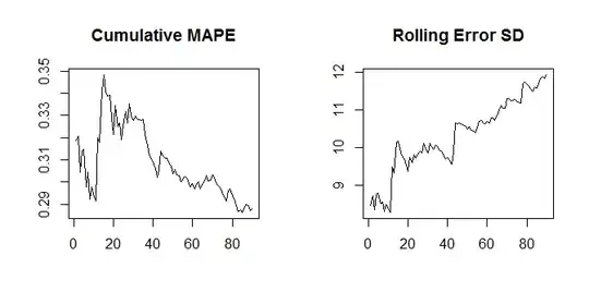

Note that the MAPE goes down as actuals go up - and the standard deviation doesn't. So for a given time series of errors (with potentially increasing SD), we could simply have a time series of actuals with a positive trend, and once the positive trend is strong enough, the MAPE will start going down.
set.seed(10)
nn <- 100
error <- rnorm(nn,0,seq(10,15,length.out=nn))
actuals <- seq(20,50,length.out=nn)
cumulative.mape <- cumsum(abs(error)/actuals)/(1:nn) cumulative.sd <- sapply(1:nn,function(xx)sd(error[1:xx]))
opar <- par(mfrow=c(1,2)) plot(cumulative.mape[-(1:10)],type="l",main="Cumulative MAPE",ylab="",xlab="") plot(cumulative.sd[-(1:10)],type="l",main="Rolling Error SD",ylab="",xlab="")
MAPE and SD
So the issue is that the MAPE depends on the error and the actuals, whereas the SD of the errors don't depend on the actuals any more (beyond the actuals influencing the errors themselves, of course). Thus, this should typically not happen for the SD and MAE, since the MAE again only depends on the errors, not the actuals.
