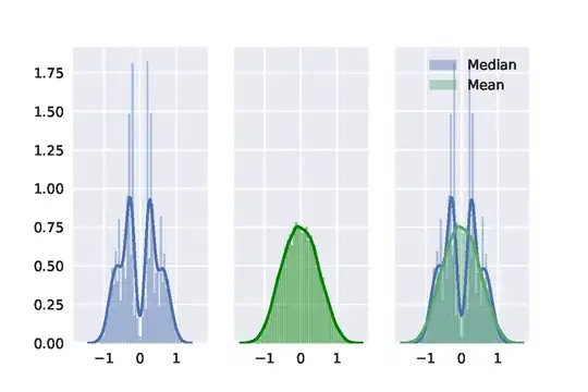

I think the distribution of the median difference in permutation test does not follow a normal distribution. Here I give some counterexamples.
First, choosing $1,\cdots, 20$ as the group data points of 20. Then using permutation test with the median difference and the mean difference between two separate groups, each of which has 10 points. The result is shown in the following figure.enter image description here Then we can see that distribution with the median difference is definitely not a normal distribution. It is also important to note that there is no zero in median difference and the smallest value is 1.

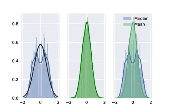

Second, I random sample 20 points from standard normal distribution. The result of permutation test is shown in the following figure.enter image description here At last, I random sample 20 points from a uniform distribution. It shows similar. The result of permutation test is shown in the following figure.enter image description here
In a nutshell, I didn't find that the distribution of the median difference in permutation test follows a normal distribution. I use a Gaussian distribution to fit the distribution of the median difference (black curve), then it is easy to see the difference. enter image description here

import seaborn as sns
import matplotlib.pyplot as plt
sns.set(color_codes=True)
%matplotlib inline
import numpy as np
#data = np.linspace(1,20,20) # first case
#data = np.random.randn(20) # second case
data = np.random.rand(20) # last case
print(data)
res_median = []
res_mean = []
for i in range(10000):
    new_data = np.random.permutation(data)
    res_median.append(np.median(new_data[:10]) - np.median(new_data[10:]))
    res_mean.append(np.mean(new_data[:10]) - np.mean(new_data[10:]))
f, (ax1, ax2, ax3) = plt.subplots(1, 3, sharex=True, sharey=True)
sns.distplot(res_median, 50, label="Median", ax=ax1)
sns.distplot(res_mean, 50, color='green', label="Mean", ax=ax2)
sns.distplot(res_median, 50, label="Median", ax=ax3)
sns.distplot(res_mean, 50, label="Mean", ax=ax3)
f.subplots_adjust(hspace=0)
plt.legend()
plt.savefig('res.pdf')
plt.show()
