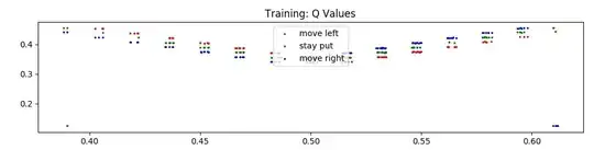

I am trying to train a Deep Q Network (https://deepmind.com/research/dqn/) for a simple control task. The agent starts in the middle of a 1-dimensional line, at state 0.5. On each step, the agent can move left, move right, or stay put. The agent then receives a reward proportional to the absolute distance from its starting state. If the agent reaches state 0.35 or state 0.65, then the episode ends. So, effectively the agent is encouraged to move all the way to the left, or all the way to the right.
For now, I am just trying to train a deep neural network in Keras / Tensorflow, to predict the q-values of the three actions, in any given state. At each time step, actions are chosen randomly, so I am just trying to see if the network can predict the correct q-values, I am not trying to get the agent to actually solve the task. However, my network is struggling to learn the correct function.
In this first figure below, the dots represent the training data available to the network on each weight update. These are stored in the experience replay buffer in the standard q-learning algorithm. As can be seen, states further from the centre have higher q-values, as would be expected. Also, when the state is greater than 0.5, higher q-values are assigned to the "move right" action, as would be expected, and vice versa. So, it seems that the training data is valid.

  • For the training data, my experience replay buffer has 400 entries (which is what each minibatch is sampled from). But the buffer itself is updated regularly, and over the course of this training it has received over 100k transitions (n = 100k). – Karnivaurus May 18 '17 at 14:35
  • For the transition model, this is deterministic. Every state and action pair will result in the same next state. – Karnivaurus May 18 '17 at 14:36
  • DQN targets should be samples of the optimal Bellman equation, $r(s,a)+\gamma \max_{a'\in\mathcal{A}}Q(s',a')$. Are you replacing $\max_{a'\in\mathcal{A}}Q(s',a')$ with the training Q's in your graph? Why do the states look discretised in some way? – rnoodle May 18 '17 at 14:57
  • In the first graph, each dot represents a transition sample. The x-axis is the current state, and the y-axis is the q-value as determined by the Bellman equation. The discretisation is because every time the agent "moves right", then it moves by a discrete amount to the right. So the agent never actually exists in states between these discrete steps. – Karnivaurus May 18 '17 at 15:05
  • So why are they grouped like that? Is it because there is a small initial state distribution? It's a bit weird. Your replay buffer is far too small for such a problem. The network will completely forget about the last 400 entries. Put all of the data into experience replay and sample uniformly. You are in batch mode remember and not online with millions of samples. – rnoodle May 18 '17 at 15:43
