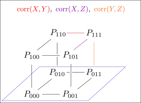

In this case, the picture from above becomes the following:
The dimensions have been bumped by one: The red vertex has become several coloured edges, and the edge covered by a blue rectangle have become an entire face. Here, the blue plane indicates that by knowing the marginal, you know the sum of the probabilities within; for the one in the picture,
$$P(X = 0) = P_{000} + P_{010} + P_{001} + P_{011},$$
and similarly for all other faces in the cube. The coloured edges indicate that by knowing the correlations, you know the sum of the two probabilities connected by the edge. For example, by knowing $\mathrm{corr}(X, Y)$, you know $E[XY]$ (exactly as above), and
$$E[XY] = P(X = 1, Y = 1) = P_{110} + P_{111}.$$
So, this puts some limitations on possible joint distributions, but now we've reduced the exercise to the combinatorial exercise of putting numbers on the vertices of a cube. Without further ado, let us provide two joint distributions whose marginals and correlations are the same:
Here, divide all numbers by $100$ to obtain a probability distribution. To see that these work and have the same marginals/correlations, simply note that the sum of probabilities on each face is $1/2$ (meaning that the variables are $\mathrm{Ber}(1/2)$), and that the sums for the vertices on the coloured edges agree in both cases (in this particular case, all correlations are in fact the same, but that's doesn't have to be the case in general).
Finally, the probabilities of getting at least one head, $1 - P_{000}$ and $1 - P_{000}'$, are different in the two cases, which is what we wanted to prove.
For me, coming up with these examples came down to putting numbers on the cube to produce one example, and then simply modifying $P_{111}$ and letting the changes propagate.
