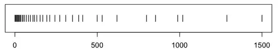

Let x be the times (in whatever unit) at which a given event has been observed.
x = c(1,2,3,7,9,14,15,20,24,28,33,35,45,50,59,70,83,95,110,119,134,153,170,
      194,212,243,273,309,350,388,412,500,530,620,800,854,989,1020, 1287,1500)
plot(x=x, y=rep(1,length(x)), pch="|", xlab="", ylab="", yaxt='n')
With these data, it is quite obvious that the rate at which events occurs is decreasing through time.
A naive way to test the hypothesis that the rate of events occurring is changing through time would be to create arbitrary time boundaries and compare the estimate rates of event occurrence in each bucket with eventually a Wald test. However, the decision of how to create buckets is arbitrary and depending on the data may yield to very different interpretations.
How can you test whether there is a change in the rate of event occurrences?

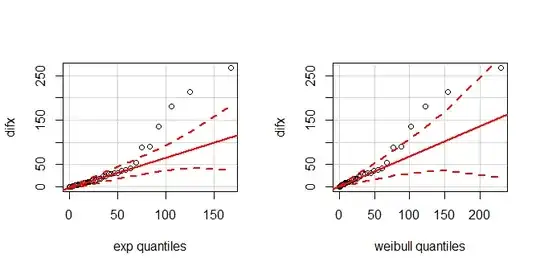

windows(width=7, height=3.5)
  layout(matrix(1:2, nrow=1))
  qqPlot(diff(x), distribution="exp",     rate=0.026)
  qqPlot(diff(x), distribution="weibull", shape=0.727, scale=30.437)
There are a couple issues here. One is that this is not the most powerful possible test of the hypothesis, another is that the sampling distribution for the KS test is not well defined when the parameters are fit from the same sample (see here: Can I use Kolmogorov-Smirnov test and estimate distribution parameters?). The KS test could pick up any deviation from the exponential, but you are specifically interested in whether the rate is getting higher or lower over time. This could be better addressed by determining if the shape parameter of the best fitting Weibull distribution differs from $1$. The exponential distribution is a special case of the Weibull when the shape is equal to $1$; if it's less, for example, then the rate is becoming slower over time. An easy way to do this is to perform a likelihood ratio test of two parametric fits, an exponential and a Weibull.
