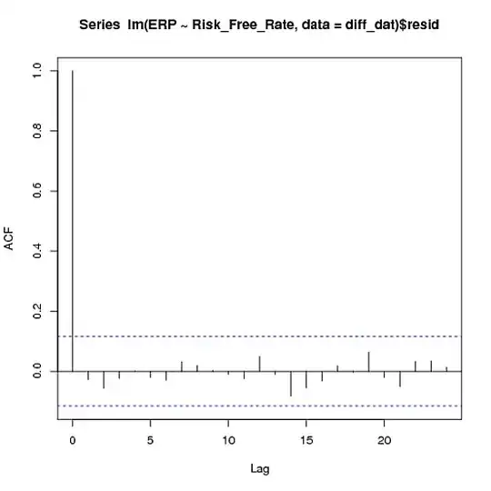

Therefore, I first difference both the dependent and explanatory variable. Here is what I get:
Coefficients:
                Estimate Std. Error t value Pr(>|t|)
(Intercept)    -0.002077   0.016497  -0.126      0.9
Risk_Free_Rate -0.958267   0.053731 -17.834   <2e-16 ***
Signif. codes:  0 ‘***’ 0.001 ‘**’ 0.01 ‘*’ 0.05 ‘.’ 0.1 ‘ ’ 1
And the ACF of the residuals looks like:
ACF function of the residuals of the regression of risk-free rate on ERP (differenced)
This result looks great: First, the residuals are now uncorrelated. Second, the relation seems to be more negative now.
