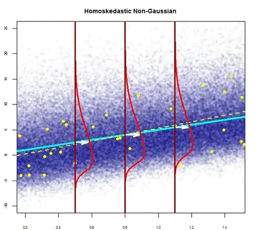

This plot tries to illustrate the distribution of points in the population in blue (with the population regression line as a solid cyan line), superimposed on a sample dataset in big yellow dots (with its estimated regression line plotted at as dashed yellow line). Evidently this is only for conceptual consumption, since there would be infinity points for each value of $X = x$) - so it is a graphical iconographic discretization of the concept of regression as the continuous distribution of values around a mean (corresponded to the predicted value of the "independent" variable) at each given value of the regressor, or explanatory variable.

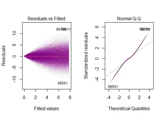

The diagnostic plots on the dataset are...
which correspond to "heavy-tailed" distribution, which makes sense is we were to telescope all the "side-by-side" vertical Gaussian plots into a single one, which would retain its bell shape, but have very long tails.
@Glen_b "... a complete coverage of the distinction between the two would also consider homoskedastic-but-not-normal."
The residuals are highly skewed and the variance increases with the values of the explanatory variable.
These would be the diagnostic plots...
corresponding to marked right skewed-ness.
To close the loop, we'd see also skewed-ness in a homoskedastic model with non-Gaussian distribution of errors:
with diagnostic plots as...
