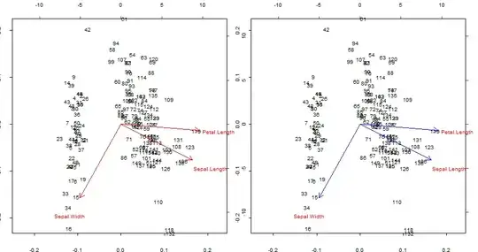

At the risk of making the question software-specific, and with the excuse of its ubiquity and idiosyncrasies, I want to ask about the function biplot() in R, and, more specifically, about the calculation and plotting of its default, superimposed red arrows, corresponding to the underlying variables.
[To make sense of some of the comments, the plots initially posted had a sclaing problem of scarce interest, and are now erased.]
amoeba
  • 104,745
  • I can't figure out how you actually got your green arrows. They are not correct. The fact that the s.length green is approx. twice longer than the s.width green allows to suspect you were plotting the vectors pertaining to the variables not standardized. That cannot happen on a biplot of PCA based on correlations. – ttnphns Apr 29 '17 at 16:38
  • Red arrows seem correct. See: they are same length and are symmetric about PC2. That is the only possible position when you do PCA with just 2 variables and based on correlations (i.e. standardized variables). In PCA based on correlations, loadings (the coordinated of the arrows) are the correlations between the PCs and the variables. In your example, the loadings are (vars by PCs): .74752, .66424; -.74752, .66424. – ttnphns Apr 29 '17 at 16:38
  • @ttnphns Yes, the red arrows are what I'm trying to reproduce (they are correct), and they are plotted in R with the biplot(name_of_the_PCA) call, which in this case is biplot(PCA). I had centered and scaled the data. – Antoni Parellada Apr 29 '17 at 16:42
  • So, what is your question? How to compute the coordinates for the red arrows? They should be the PCA loadings. Sometimes, eigenvectors are plotted (your R command probably did that??), however, the consensual, meaningful way is to plot loadings. – ttnphns Apr 29 '17 at 16:49
  • @ttnphns Plotting the eigenvectors (I assume it's the same as the loadings) gives me the right orientation (thank you), but not the same magnitude as the red arrows (I'm pasting the image in the OP). – Antoni Parellada Apr 29 '17 at 16:54
  • Antony, loadings are not eigenvectors. Please read my links. (R documentation labels eigenvectors "loadings" ... (to say it soft) ... recklessly. This issue was asked by users here million of time. Once again, my recommendation: always plot loadings as the "arrows", irrespective of what R or other software does for you by default. In your PCA, the loadings must be (s.length, s.width by PC1 PC2) .74752, .66424; -.74752, .66424 – ttnphns Apr 29 '17 at 16:57
  • @AntoniParellada Did you see my answer here https://stats.stackexchange.com/questions/141085 ? Does it clear it up? – amoeba Apr 29 '17 at 19:35
  • Hmm, regarding your Edit: the little green arrows are NOT in the same direction as the red arrows. Increase their length and you will see. – amoeba Apr 29 '17 at 19:39
  • I think that my linked answer should fully answer this question (I am even considering to vote to close this one as a duplicate). Maybe you can ping me here after you go over it if you still cannot make it work. – amoeba Apr 29 '17 at 19:41
  • @amoeba I did see your answer yesterday... Really good! To tell you the truth, the nine combinations are throwing me off a bit, and until I see it with R I won't fully "see it". If you don't mind it, can you give some time, and see if I can come up with something (I know that code-specific Q&A are frowned upon), and I'll be the first one to delete the post if it doesn't offer anything - I'm thinking about something simpler than your answer. – Antoni Parellada Apr 29 '17 at 20:52
  • Antoni, I did not mean that you should delete this question (I already upvoted it). Neither do I think that questions of the form "WTF is this statistical software doing when I run this command??" should be off-topic of frowned upon. This topic is confusing, and it took me a lot of time back then to understand what exactly R is doing here. Note that my answer mentions briefly which of the 9 combinations R uses. Starting from there, it should be pretty straightforward to reproduce the biplot that you show in this question. – amoeba Apr 29 '17 at 21:07
  • @amoeba No sweat! You always help me... Thank you! I'm working on it, and I think I'm getting where I messed up to begin with... – Antoni Parellada Apr 29 '17 at 21:09
  • One mistake in your original (before the Edit) code seems to be that you project the non-standardized data onto the PCA$rotation, whereas you should be projecting the standardized data. Regarding the scaling issue, it should be $\sqrt{150-1}$ factor -- see explanation in the same answer... – amoeba Apr 29 '17 at 21:11
  • @amoeba Exactly! That is the part I had realized at the time of my prior comment - the code error. Now with the $\sqrt{150 -1}$ you just tipped me off to, it all falls in place... – Antoni Parellada Apr 29 '17 at 21:27
  • @ttnphns Really sorry to bother you, again. Going over this, and realized that at no point in all the code in the answer below do I get your values above: .74752, .66424; -.74752, .66424. Could you please tell me what line of code did you use? – Antoni Parellada May 08 '17 at 02:20
  • Antoni, I didn't use R, I used SPSS. These are the loadings I got. PCA of your 2 variables was done on their correlations. Eigenvalues of the corr matrix (r= -.11757) were 1.11756 .88243 and eigenvector values were all +/- .707106. The full iris data is here. – ttnphns May 08 '17 at 06:28
  • Antoni, note that in your code below you submit 3 iris data variables to PCA, not 2 variables as I did in the comments and you did in your initial question. – ttnphns May 08 '17 at 09:45
  • @ttnphns Right! Thank you... I forgot we started off with 2 variables... If I enter X = as.matrix(iris[,1:2]) at the beginning of the code in my answer, I get your values for loaded (in the notation in the same chunk of code). – Antoni Parellada May 08 '17 at 12:14

Duplicating and overlapping in blue the red arrows of biplot()
par(mfrow = c(1,2)); par(mar=c(1.2,1.2,1.2,1.2))
biplot(PCA, cex = 0.6, cex.axis = .6, ann = F, tck=-0.01) # R biplot
# R biplot with overlapping (reproduced) arrows in blue completely covering red arrows:
arrows(0, 0,
       cor(X[,1], scr[,1]) * 0.8 * sqrt(nrow(X) - 1),
       cor(X[,1], scr[,2]) * 0.8 * sqrt(nrow(X) - 1),
       lwd = 1, angle = 30, length = 0.1, col = 4)
arrows(0, 0,
       cor(X[,2], scr[,1]) * 0.8 * sqrt(nrow(X) - 1),
       cor(X[,2], scr[,2]) * 0.8 * sqrt(nrow(X) - 1),
arrows(0, 0,
       cor(X[,3], scr[,1]) * 0.8 * sqrt(nrow(X) - 1),
       cor(X[,3], scr[,2]) * 0.8 * sqrt(nrow(X) - 1),

# Function to get the range:
unsigned.range = function(x) c(-abs(min(x, na.rm = TRUE)),
                                abs(max(x, na.rm = TRUE)))
rangx1 = unsigned.range(x[, 1L])               # Range first col x
# -0.1418269  0.1731236
rangx2 = unsigned.range(x[, 2L])               # Range second col x
# -0.2330564  0.2255037
rangy1 = unsigned.range(y[, 1L])               # Range 1st scaled evec
# -6.288626   11.986589
rangy2 = unsigned.range(y[, 2L])               # Range 2nd scaled evec
# -10.4776155   0.8761695
(xlim = ylim = rangx1 = rangx2 = range(rangx1, rangx2))
# range(rangx1, rangx2) = -0.2330564  0.2255037
# And the critical value is the maximum of the ratios of ranges of
# scaled e-vectors / scaled scores:
(ratio = max(rangy1/rangx1, rangy2/rangx2))
# rangy1/rangx1   =   26.98328    53.15472
# rangy2/rangx2   =   44.957418   3.885388
# ratio           =   53.15472
par(pty = "s")                                 # Calling a square plot
# Plotting a box with x and y limits -0.2330564  0.2255037
# for the scaled scores:
plot(x, type = "n", xlim = xlim, ylim = ylim)  # No points
# Filling in the points as no's and the PC1 and PC2 labels:
text(x, xlabs)
par(new = TRUE)                                # Avoids plotting what follows separately
# Setting now x and y limits for the arrows:
(xlim = xlim * ratio)  # We multiply the original limits x ratio
# -16.13617  15.61324
(ylim = ylim * ratio)  # ... for both the x and y axis
# The following doesn't change the plot intially...
plot(y, axes = FALSE, type = "n",
     xlim = xlim,
     ylim = ylim, xlab = "", ylab = "")
# ... but it does now by plotting the ticks and new limits...
# ... along the top margin (3) and the right margin (4)
axis(3); axis(4)
text(y, labels = ylabs, col = 2)  # This just prints the species
arrow.len = 0.1                   # Length of the arrows about to plot.
# The scaled e-vecs are further reduced to 80% of their value
arrows(0, 0, y[, 1L] * 0.8, y[, 2L] * 0.8,
       length = arrow.len, col = 2)
which, as expected, reproduces (right image below) the biplot() output as called directly with biplot(PCA) (left plot below) in all its untouched aesthetic shortcomings:
Points of interest:
  • The arrows are plotted at a scale related to the maximum ratio between the scaled eigenvector of each one of the two principal components and their respective scaled scores (the ratio). AS @amoeba comments:
the scatter plot and the "arrow plot" are scaled such that the largest (in absolute value) x or y arrow coordinate of the arrows was exactly equal to the largest (in absolute value) x or y coordinate of the scattered data points
  • As anticipated above, the points can be directly plotted as the scores in the matrix $\mathbf U$ of the SVD:
