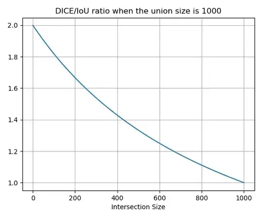

You can look at the ratio between DICE and IoU, it may be interesting:
$$ IoU = \frac{|A \cap B|}{|A \cup B|} $$
$$ DICE = \frac{2|A \cap B|}{|A| + |B|} $$
To compute the ratio, we would like to divide DICE by IoU, but need to be careful not to divide by zero, which will be the case when $|A \cap B| = 0$. In such case, by just looking at the metric definitions, we can notice that they both will be identically 0.
Recall that $|A \cup B| = |A| + |B| - |A \cap B| \Longrightarrow |A \cup B| + |A \cap B| = |A| + |B|$
So, suppose that $|A \cap B| > 0$, we get:
$$ \frac{DICE}{IoU} = \frac{2|A \cap B| |A \cup B|}{(|A| + |B|)|A \cap B|} = \frac{2|A \cup B|}{|A| + |B|} = \frac{2|A \cup B|}{|A \cup B| + |A \cap B|} $$.
Now, we know that $|A \cap B| \le |A \cup B|$, which means that:
  • When the $A \cap B = \emptyset$, both metrics are identical and equal to 0 and the ratio cannot be computed.
  • When $A = B \Longrightarrow |A \cap B| = |A \cup B|$, the ratio will be 1, meaning that the two metrics are again identical, and both equal to 1.
  • In all other cases, since $|A \cap B| < |A \cup B|$, the ratio will be in $[1,2)$, meaning that DICE will be up to 2x larger that IoU.
To conclude,
  • DICE and IoU will be identical when $A = B$ or when $A \cap B = \emptyset$
  • When the intersection rate is very small but not identically 0, DICE will tend to be up to 2x larger than IoU, but never identically 2x.
  • The higher the intersection rate, the closer DICE and IoU will be, while DICE will remain somewhat larger than IoU, as long as the two sets aren't identical.
Here you can see the relationship between them visually. The union size is set to 1000 and the DICE/IoU ratio is plotted where the intersection size runs from 1 to 1000...
Ratio visualization
Here is the difference between them: diff visualization
Here the two metrics are plotted individually, under the same conditions:
visualization
