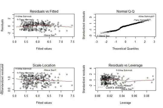

When I fit the full model, i seem to have non-constant variance of the error and also deviance from normality. I have applied a log transformation of the response variable: This removes the non constancy of the error but adds a curvature in the qqplot. I would like to use my model for frequenstist prediction and baysian prediction. I am aware thet deviations from normality can cause inacurrate prediction results. What should I do about the non-normality?

The response variable is Salary: enter image description here
EDIT 2: Added Variable Plots (as kindly suggested by Whuber)
As far as I know Added variable plots are used to detect disproportionate influence of observations. I do not see anything suspicious here that would explain or suggest the indicated bimodality.
Am I missing something here?

1) I always advise against using tests for normality. They answer a question you already know the answer to, i.e. "Is your data normal?" (The answer is no because nothing is normal) vs the question "Is the lack of normality going to be a problem?" which is the question you should be interested in.
2) The assumption of normality is not so much about the predictive performance, but rather the correctness of the inference you would perform (hypothesis tests and confidence intervals).
3) Some deviation from normality is okay, because we have asymptotics that drive test statistics to normality.
4) You QQ-plot does not appear to be severely not normal (although there might be some bimodality in your residuals. You may want to check if there is an omitted variable or something). As another commenter stated, the normality is the one that can kind of fail (can have mild - moderate deviations from it).
5) So to answer your question
(i) Yes, you do the log transform (or some other transformation) first.
(ii) Once you transform your variable the nonnormality EDIT may be worth looking to see why the residuals seem to be in two distinct clusters.

    +1 Good advice. I'm unsure about the merits of your last conclusion, though, because it might be giving up too soon. The QQ plot rather strongly suggests two clusters of residuals. Pursuing that idea through further exploration may yield valuable insight. – whuber Apr 10 '17 at 16:55
  • @whuber how should i proceeed in order to explore the bimodality? – Nneka Apr 11 '17 at 05:20
  • @Josh: what do you mean with asymptotics that drive test statistics to normality? Can you elaborate please? – Nneka Apr 11 '17 at 15:22
  • One way is to search for a (binary?) covariate that would be associated with the modes. Another is to perform a cluster analysis of the residuals. Further exploration can be helpful, such as added-variable plots. – whuber Apr 11 '17 at 16:17
  • We know as your sample size grows larger, the standardized version of your least squares estimators begin to hold a standard normal distribution (under of course mild regularity conditions) . The is why the t test is robust and why mild to moderate deviations from normality don't affect a lot of the inference. – Josh Apr 11 '17 at 18:31
  • @whuber i actually had the added-variable plots in my code, but didn´t see any indications of extraordinary behaviour. I have edited these to the question now. Can I conclude from these the is no bimodality? – Nneka Apr 11 '17 at 20:47
  • On the contrary--the bimodality won't go away just because you fail to find an explanation! The AVPs are quite clear about the bimodality, too: the separation is beautiful. They present an interesting puzzle if you would like to investigate it: namely, to discover what characteristic distinguishes these components of the residual distribution. – whuber Apr 11 '17 at 20:57

  • @hxd1001 thank you for your input. As fas as I know prediction intervals strongly depend on the normality of the errors, otherwise the model is likely to yield inaccurate results? Based on the QQ-plot I conclude my residuals are not normaly distibuted. Is this a problem? – Nneka Apr 10 '17 at 16:14
I wouldn't worry about normality, at least, at this stage of your analysis. Try using log transformation on the dependent variable. Salary's a good candidate for log-transform. This removes skewness, then you'll be good to continue analysis.

  • I have done transformation on the dependent variable, which indeed fixed the non-constancy of error variance, but introduced curvature in the QQ-plot. My concern is that I want to use this model for prediction, which is strongly depend on the normality of the errors – Nneka Apr 10 '17 at 16:16
