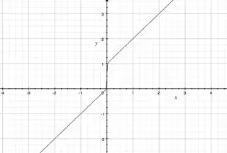

Let $I(x_i)$ be an indicator for $x$ being greater than zero. Of course you could run the regression:
$$ y_i = b_0 + b_1 x_i + b_2 I(x_i) + \epsilon_i $$
And this would be a sensible thing to do if your conditional expectation function had a discontinuity of some unknown size at zero. For example:
Sure there's going to be some correlation between $x$ and $I(x)$, but that's part of the reason you run a regression with multiple regressors rather than estimating everything separately. Too correlated though and you do have a problem, but I'd think you're probably ok.
