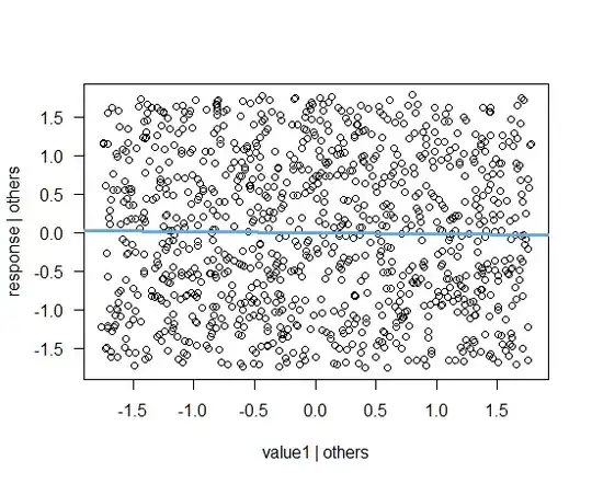

Again using the above data:
# Added-variable plot
model2 <-lm(response ~ value2 + value3 + sex, data=df)
resid2 <- residuals(model2)
model3 <- lm(value1~value2 + value3 + sex, data=df)
resid3 <- residuals(model3)
plot(resid2~resid3, las = 1, xlab = "value1 | others", ylab = "response | others")
abline(lm(resid2~resid3), col = "steelblue2", lwd = 3)
Added-variable plot
This plot has some very useful properties:
  • As in the partial-residual plot, the slope of the regression line is identical with the slope of the focal predictor $x_i$ in the full model.
  • In contrast to the partial-residual plot, the residuals of the regression line in the added-variable plot are identical with the residuals of the full model.
  • Because the values on the x-axis show values of the focal predictor $x_i$ conditional on the other predictors, points far to the left or right are cases for which the value of $x_i$ is unusual given the values of the other predictors. Hence, influential data values can be easily seen.
  • The plot can be useful to detect nonlinearity, heteroscedasticity and unusual patterns.
Comparison
The Wikipedia page on the partial regression plot summarizes (small changes are mine):
Partial regression plots [added-variable plots] are related to, but distinct from, partial residual plots. Partial regression plots are most commonly used to identify data points with high leverage and influential data points that might not have high leverage. Partial residual plots are most commonly used to identify the nature of the relationship between $Y$ and $X_i$ (given the effect of the other independent variables in the model). Note that since the simple correlation between the two sets of residuals plotted is equal to the partial correlation between the response variable and $X_i$, partial regression plots will show the correct strength of the linear relationship between the response variable and $X_i$. This is not true for partial residual plots. On the other hand, for the partial regression plot, the x-axis is not $X_i$. This limits its usefulness in determining the need for a transformation (which is the primary purpose of the partial residual plot).
