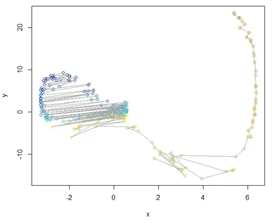

2/ Manifold identification to transform points to a time-series. This works a little better, although it is very sensitive to the chosen parameter. I tested kPCA, LLE and isomap. Only isomap gives correct outputs.
## Order according to the 1st component of linear PCA
# (will not work for this example, even with a nonlinear kernel)
library(kernlab)
library(colorRamps)
kpc <- kpca(~.,data=data.frame(M), kernel="vanilladot", kpar = list(), features = 2)
out_kpc = predict(kpc,data.frame(M))[,1]
plot(M, col = blue2red(300)[cut(out_kpc,300,labels=FALSE)])
## Isomap:
# * Global manifold learning
# * Need compute of the distance, so can be very long with > 2000 points
library(vegan)
library(colorRamps)
out_isomap = isomap(dist(M), k=5, ndim = 1)
plot(M, col=blue2red(300)[cut(out_isomap$points,300,labels=FALSE)])
# k < 5 : Data are fragmented
# 5 <= k <= 11 : OK
# k > 11 : Looks like PCA
## LLE:
# * Local manifold learning (may not be suitable for some applications)
# * Quicker than isomap
library(lle)
library(colorRamps)
out_lle = lle(M, m = 1, k=9)
plot(M, col=blue2red(300)[cut(out_lle$Y,300,labels=FALSE)])
Here is the result with isomap. From this result, I can try to smooth the obtained time series ('the obtained time series' = the curve shown in gray)... enter image description here
