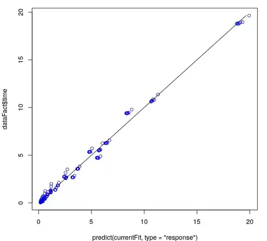

I have a following generalised linear model with logarithm link function in R
Call:
glm(formula = time ~ I(1/nprocs) + nDOF + I(nDOF^2) + ndoms +
    nDOF:ndoms + I(nDOF^2):ndoms + I(nDOF^3):ndoms, family = gaussian(link = "log"),
    data = dataFact)
Deviance Residuals:
     Min        1Q    Median        3Q       Max
-0.98297  -0.14332  -0.09090   0.02355   1.09854
Coefficients:
                  Estimate Std. Error t value Pr(>|t|)
(Intercept)     -2.148e+00  1.811e-01 -11.861  < 2e-16 ***
I(1/nprocs)      6.319e-02  1.487e-02   4.250 3.18e-05 ***
nDOF             4.038e-04  3.476e-05  11.615  < 2e-16 ***
I(nDOF^2)       -1.154e-08  1.575e-09  -7.325 4.68e-12 ***
ndoms            8.157e-04  2.178e-04   3.746  0.00023 ***
nDOF:ndoms       2.678e-07  5.918e-08   4.525 9.96e-06 ***
I(nDOF^2):ndoms -3.270e-11  5.757e-12  -5.680 4.32e-08 ***
ndoms:I(nDOF^3)  1.174e-15  1.932e-16   6.075 5.53e-09 ***
Signif. codes:  0 ‘***’ 0.001 ‘**’ 0.01 ‘*’ 0.05 ‘.’ 0.1 ‘ ’ 1
(Dispersion parameter for gaussian family taken to be 0.1183373)
    Null deviance: 3891.805  on 223  degrees of freedom
Residual deviance:   25.561  on 216  degrees of freedom
AIC: 167.48
Number of Fisher Scoring iterations: 5
I want to use it as a predictive model, so I'd like to evaluate two main criteria:
  • goodness of fit on the whole train data set
  • "goodness of prediction" by 10-fold cross-validation
I'd like to have some argument (together with some "rule of thumb"), so that I could say, that my model is "good enough", not only that it's better than some other model (which I can say now considering AIC).
Fit on the whole training data set
1st attempt
I considered using Nagelkerke pseudo-R2, but I'm not sure, if it's compatible with my GLM model (gaussian family, but logarithm link function).
Moreover, I'm worried about its "performance" on larger data sets (about 10000 observations), where the formula has a lot of terms.
Pseudo-R2 for my fit looks like this:
Nagelkerke R2:
$N
[1] 224
$R2
[1] 1
As we can see from plots, while the fit is pretty good, it's definitely not perfect, so I'd expect R2 about 0.98, not 1.
2nd attempt
I thought about the interpretation of Null and residual deviance. I know, that residual deviance tells me about the improvement of the "null model" by my formula, but I'm not able to interpret it as the absolute value, so I could say, that the improvement is good enough.
I found following formula (in this answer), but I don't know if it's correct to interpret its result in the way "when this number is larger than 0.9, then my model is ok".
1 - (Residual Deviance/Null Deviance)

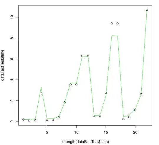

Goodness of prediction by 10-fold cross-validation
Here I'm trying to perform 10 iterations of cross-validation and store RMSE in every iteration, so I can compute its mean and standard deviation (like it was recommended in this answer).
The result looks like this:
mean(RMSE)=0.367754, sd(RMSE)=0.076150
My problem is, again, the interpretation - how can I say, that those numbers are good enough for the model to be considered well-predicting or otherwise?
Plots of fit on the whole training data set
Examples of plots of cross-validation
enter image description here enter image description here enter image description here
