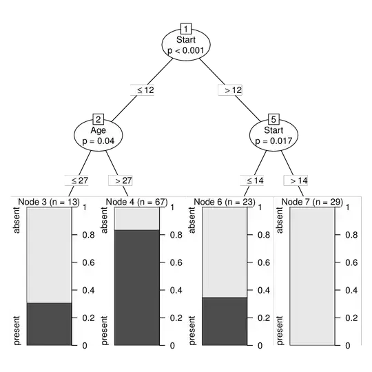

This is a rather theoretical question, so I'm sorry if that's not appropriate to the platform. I have trained a decision tree (partykit) on an imbalanced data set, and to force the model to learn both positive and negative examples I have up-sampled the data to be balanced. On a validation/test set performance was more than decent (balanced accuracy > 80%). However, when trying to interpret the tree with business users, they were surprised with inflated prediction probabilities and I think those probabilities are distorted since the data was up-sampled. Is there anyway to stream the test set (which is not balanced) through the tree and get the prediction probabilities on the test set (both visually and by printing the tree )?

The tree on the upsampled data can be created, printed, and visualized by:
ct2 <- ctree(Kyphosis ~ ., data = ky2)
print(ct2)

plot(ct2)
ctree with upsampling
To associate the same tree/node structure with the original kyphosis data without subsampling we just need to: extract the tree ($node), get the fitted nodes and observed response, and add data and terms. This can then also be converted into a constparty (recursive partyitioning with constant fits) and printed/visualized.

plot(ct)
ctree without upsampling
