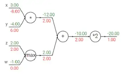

I'd like to recommend this limpid article: CS231n Convolutional Neural Networks for Visual Recognition, and let me compare the (simplified) vanilla network with the (simplified) residual network as follows.
Here is a diagram I borrowed from that page:
where the green numbers above the lines indicate the forward pass, and the red numbers the backward pass(with the initial gradient 1).
