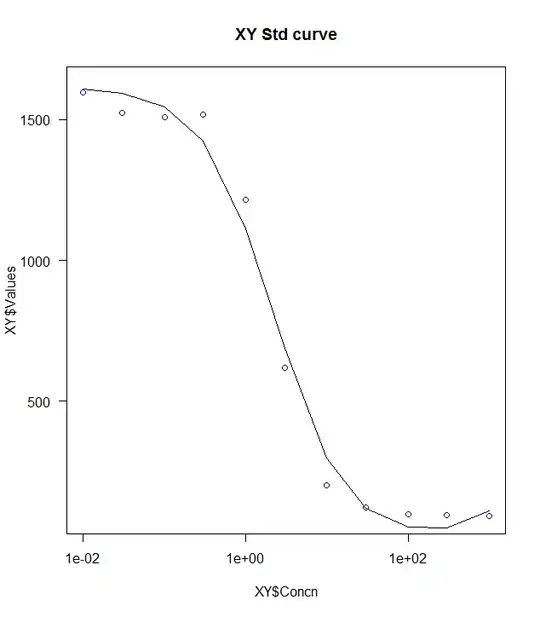

I am trying to plot model fit curve. I am not able to get a smoother fit curve. Any advice?
XY <- data.frame(cbind(Values = c(91.8, 95.3,   99.8,   123.3,  202.9,  619.8,  1214.2, 1519.1, 1509.2, 1523.3, 1595.2, 1625.1),
            Concn = c(1000, 300,    100,    30, 10, 3,  1,  0.3,    0.1,    0.03,   0.01,   0)))
nls.fit <- nls(Values ~ (ymax* Concn / (ec50 + Concn)) + Ns*XY$Concn + ymin, data=XY,
       start=list(ymax=max(XY$Values), ymin = min(XY$Values), ec50 = 3, Ns = 0.2045514))
plot(XY$Values ~ XY$Concn , data = XY, col = 4,
     main = "XY Std curve", log = "x")
lines(XY$Concn, predict(nls.fit))
RanonKahn
  • 175
  • Try estimating a cubic relationship, i.e., using OLS and adding squared and cubed versions of your independent variable. – rolando2 Mar 12 '17 at 17:07
  • You might do better on a programming site if you do not get any useful responses here. – mdewey Mar 12 '17 at 17:10
  • I'm doubtful about my suggestion. Any curve I get is still jagged. – rolando2 Mar 12 '17 at 17:25
    @mdewey This is not a problem that will be solved by writing a better program. It's also not going to be solved by throwing polynomial terms into the mix. The method I describe at http://stats.stackexchange.com/a/83613/919 will work very well to fit the data, provided a more suitable functional form is adopted. In other words, I recommend two fundamental changes: replace the rational function with one that is supported by theory (most likely predicting an exponential decay) and replace nls by a loss function that forces a close fit near the smallest and largest responses. – whuber Mar 12 '17 at 17:28
