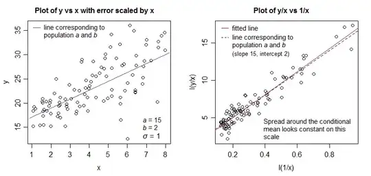

A simulated example where it works well:
Plot 1: data with sd proportional to x; Plot 2: transformed as above showing linear trend with constant variance and the roles of a and b reversed
