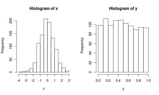

One common way of performing a one-to-one transformation from $\mathbb{R}$ into $[0; 1]$ is to calculate the CDF of the original variable. The "problem" with that approach is that the result will be uniformly-distributed. This is a well-known property, but here is an example to illustrate:
set.seed(2345)
x <- rnorm(1000)
hist(x)
y <- pnorm(x)
hist(y)
The histograms of $x$ and $y$ will look like this: Histograms of x and y
However, as I mentioned, I would like to transform $X \in \mathbb{R}$ into $Y \in [0; 1]$ and have $Y$ bell-shaped?

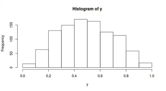

One solution would be to use the CDF of a logistic distribution. In the example:
set.seed(2345)
x <- rnorm(1000)
y <- 1 / (1 + exp(-x))  # assumes mu = 0 and sd = 1 for Y.
This should give the following histogram for $y$: histogram of y
At first this seems to answer my question, but I welcome other solutions very much, since this transformation may be too similar to another method I am using and comparing.
