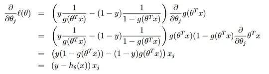

But in this CS229 course notes from Andrew Ng's, on page 18, I have found the demonstration from Andrew Ng's gradient ascent formula. I only add it here as a demostration: enter image description here
Note: the formula above is for Gradient Ascent.
I'm not sure if I have understood everything, but in this derivative I see have the derivative from f function disappears (f function is the sigmoid function).

Both formulas are correct. Here is how you can get formula 2, by minimize the sum of squared errors. $$ \sum^n_i(y^i-\hat{y^i})^2 $$ Dividing it by $n$ gives you MSE, and by $2$ gives you SSE used in the formula 2. Since you are going to minimize this expression with partial derivation technique, choosing $2$ makes the derivation look nice.
Now you use a linear model where $\hat{y} = f(h)$ and $h(x) = \theta{x}$, you get, (I omit the transpose symbol for $\theta$ in $\theta^T{x}$) $$ \frac{1}{2}\sum^n_i(y^i-{f(\theta{x^i})})^2 $$ When you compute its partial derivative over $\theta$ for the additive term, you have, $$ \frac{\partial}{\partial\theta_j}(\frac{1}{2}(y-{f(\theta{x})})^2) = -(y-\hat{y}) f'(\theta{x}) x_j \quad (1) $$
This is the formula 2 you gave. I don't give the detailed steps, but it is quite straightforward.
Yes, $f(h)$ is the activation function, and you do have the factor $f'(h)$ in the derivative expression as shown above. It disappears if it equals 1, i.e., $f(h) = h + c$, where $c$ is invariable w.r.t. $h$.
For example, if $h_\theta(x) = \theta{x}$, (i.e., $\sum^n_i{\theta_i{x_i}}$), and the prediction model is linear where $f(x) = \theta{x}$, too, then you have $f(h) = h$ and $f'(h) = 1$.
For another example, if $h_\theta(x) = \theta{x}$, while the prediction model is sigmoid where $f(h) = \frac{1}{1+e^-h}$, then $f'(h) = f(h)(1-f(h))$. This is why in book Artificial Intelligence: A Modern Approach, the derivative of logistic regression is: $$ \frac{\partial}{\partial\theta_j}(\frac{1}{2}(y-{f(\theta{x})})^2) = -(y-\hat{y}) \hat{y}(1-\hat{y})x_j \quad (2) $$ On the other hand, the formula 1, although looking like a similar form, is deduced via a different approach. It is based on the maximum likelihood (or equivalently minimum negative log-likelihood) by multiplying the output probability function over all the samples and then taking its negative logarithm, as given below, $$ \sum^n_i-\log{P(y^i|x^i; \theta)} $$
In a logistic regression problem, when the outputs are 0 and 1, then each additive term becomes,
$$ −logP(y^i|x^i;\theta) = -(y^i\log{h_\theta(x^i)} + (1-y^i)\log(1-h_\theta(x^i))) $$
The formula 1 is the derivative of it (and its sum) when $h_\theta(x) = \frac{1}{1+e^{-\theta{x}}}$, as below, $$ \frac{\partial}{\partial\theta_{j}}(−logP(y|x;\theta)) = -(y - \hat{y})x_j \quad (3) $$ The derivation details are well given in other post.
You can compare it with equation (1) and (2). Yes, equation (3) does not have the $f'(h)$ factor as equation (1), since that is not part of its deduction process at all. Equation (2) has additional factors $\hat{y}(1-\hat{y})$ compared to equation (3). Since $\hat{y}$ as probability is within the range of (0, 1), you have $\hat{y}(1-\hat{y}) < 1$, that means equation (2) brings you a gradient of smaller absolute value, hence a slower convergence speed in gradient descent than equation (3).
Note the sum squared errors (SSE) essentially a special case of maximum likelihood when we consider the prediction of $\hat{y}$ is actually the mean of a conditional normal distribution. That is, $$ p(y | x) = N(y;\hat{y},I). $$ If you want to get more in depth knowledge in this area, I would suggest the Deep Learning book by Ian Goodfellow, et al.

The two formulas are for different loss functions, one of which is generally much better than the other when performing logistic regression.
The first formula is used for calculating the output node deltas when using binary cross entropy loss and a sigmoid activation function for the output nodes. This is the formula I would use for logistic regression, and it also happens to be the formula for linear regression despite a different derivation.
The second formula is a more general expression for using mean squared error loss when you have an activation function for your output node. In the case of linear regression, f′(h) = 1, because there is no activation function (it's the identity function), so you're left with the first formula. In the case of logistic regression, f′(h) = f(h) * (1 - f(h)). I would not recommend using mean squared error loss for logistic regression, as it's very slow. Binary cross entropy is a much better loss function to use with logistic regression.
