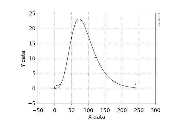

I also tried fitting the data you posted to a double exponential equation with similar results.
If you might use a different equation, I was able to fit the data you posted to the Extreme Value peak equation with good results as shown in the attached graph. It seems to fit well near the origin also.
y = a * exp(-exp(-((x-b)/c))-((x-b)/c)+1.0)

Graph of fitted Extreme Value Peak
  • Thanks! This was exactly what I was looking for! What fitting command did you use in R? Just so I can read up on it :) – Gliz Feb 14 '17 at 09:42
  • I did not use R. Years ago I ran a online curve and surface fitting web site named zunzun.com, and this had a "function finder" with a genetic algorithm front end for initial parameter estimation. I used the code to fit your data to over two hundred known equations with three or less parameters, and chose this one from the sorted results. The Python BSD-licensed source code is here if you would like to try it: https://github.com/zunzun/zunzunsite3 – James Phillips Feb 14 '17 at 14:02
